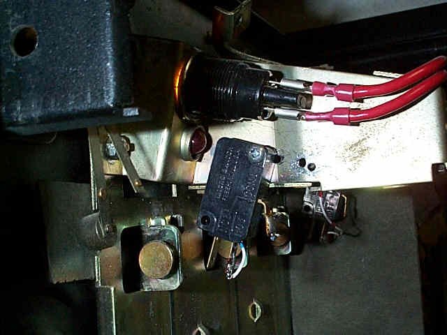

      Once the control panels were completed, I had to devise a way to coin up the games.  I wanted to keep the machine as classic as possible without having to stuff quarters in it.  The final solution was to install micro switches behind the coin return buttons.  All the player has to do now is touch the coin return and the credit is registered.  This worked so well that I eventually converted all the machines in my collection to coin up this way.
